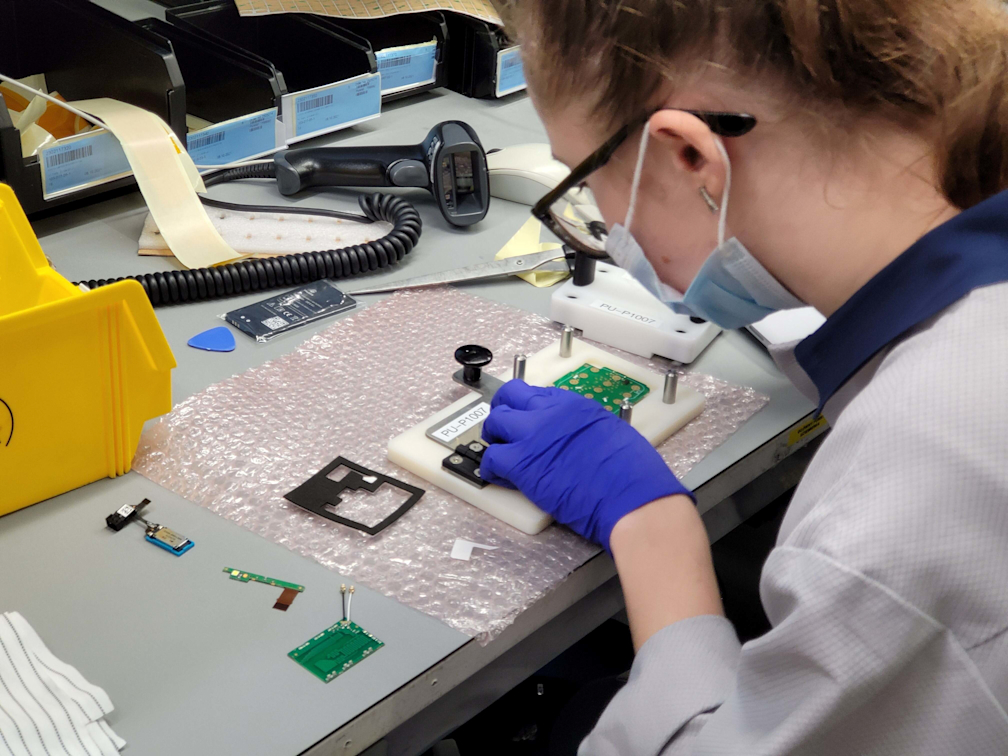

Introducing new products which meet customer expectations is quite a difficult process. NPI allows us to detect potential issues before mass production. During this NPI process, our manufacturing partner was able to manufacture approximately 10-15 phones per day (with limited capacity of course). Each device was individually tested by the EOL tester. The EOL (End of Line) tester is used to check the whole device after assembly (test of screen, backlight and keyboard, speakers, microphone, cellular module, flashlight, audio jack).
While we detected a few defects in some of the devices, the objective of the NPI is for the deployment process to be iterated until the desired end result is achieved. At this point, approximately 90% of manufactured devices pass the EOL tester. Ultimately, we manufactured about 120 Mudita Pure phones during the final NPI.  This will allow us to test, validate, and fine-tune all our processes, so we can have a seamless transition to mass production, which we plan on starting on November 15th.
A production team member assembling Mudita Pure
