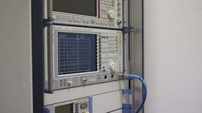

In order to measure the phone radiation that we absorb researchers use models of the human head and body which are filled with liquids that simulate different kinds of human tissue.
The test is taken when the phone along with a measuring device is placed on a special handle in close proximity to the model head or torso. What happens is that the robotic probe makes a series of precise measurements of the electric field in different positions of the phone against the model.
Everything takes place in an anechoic chamber which absorbs electromagnetic waves that otherwise could affect the results of the test. The mobile phone is tested when it’s operating at its highest power and at different frequency bands.
The test simulates the situation of holding the phone during a call, including both to the left and right side of the head, and the radiation our body is exposed to that is involved in it. Only the highest SAR values are shown on the smartphone’s packaging.
