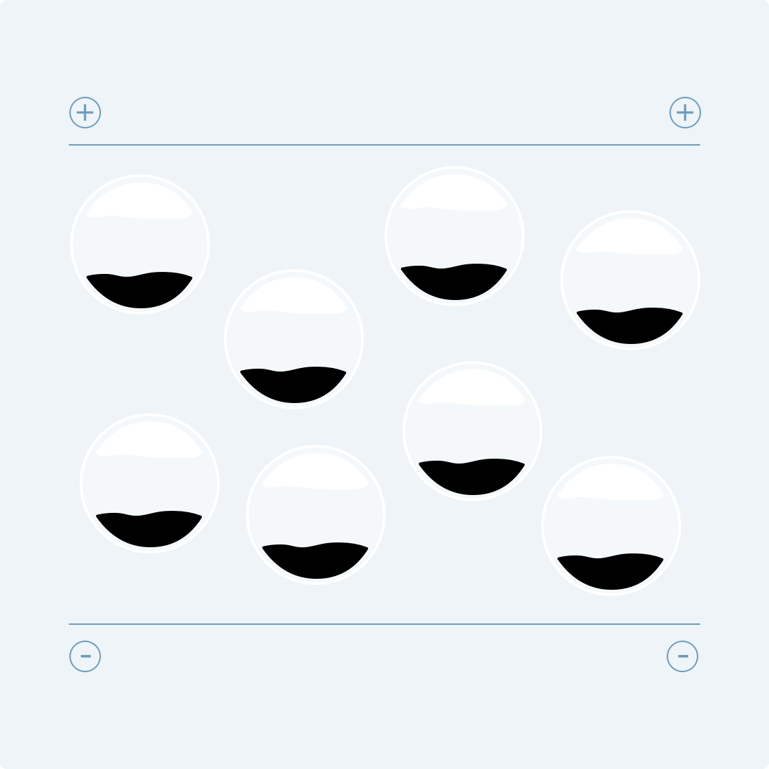

  • Electronic paper works thanks to millions of tiny ink capsules.
    These ink capsules are filled with a transparent fluid. The fluid within each capsule contains minuscule particles, approximately as wide as human hair. E Ink displays consist of millions of these capsules in a thin film, with differing electrical charges and colors.

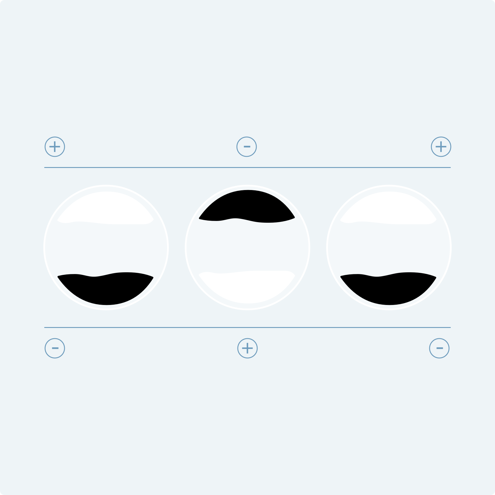

  • Color particles inside capsules are moved by electric charge.
    Above and below the capsules film electrodes are placed. When a positive or negative electric field is applied to an individual electrode, the color particles with the corresponding charge will move either to the top or bottom of the capsule.

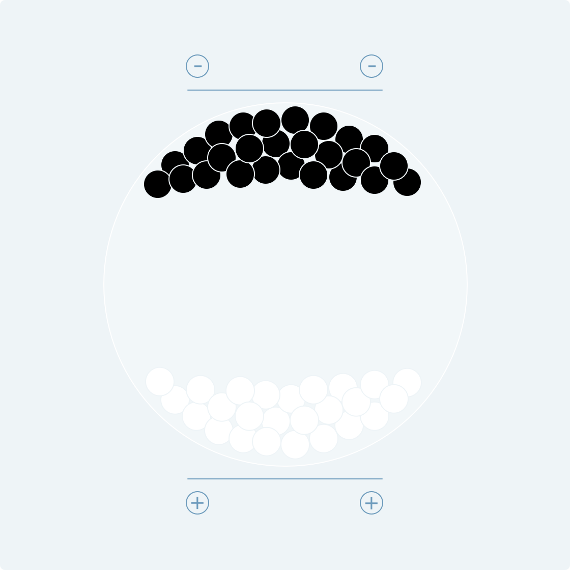

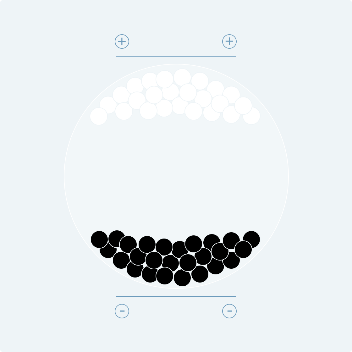

  • Differently colored particles.
    The particles inside an e-ink capsule in the simplest version of an e-paper display will be white or black. The ink particles which carry a positive charge are white and the ink particles which carry a negative charge are black.
  • EPD gets colored by the capsules.
    Capsules filled with negatively and positively charged particles color the surface of an EPD when an electric charge is applied. When a negative electric charge is applied, the particles which are black (and negative) are forced to the top of the capsule. In the areas where the black particles are, the surface of the display appears black in colour.

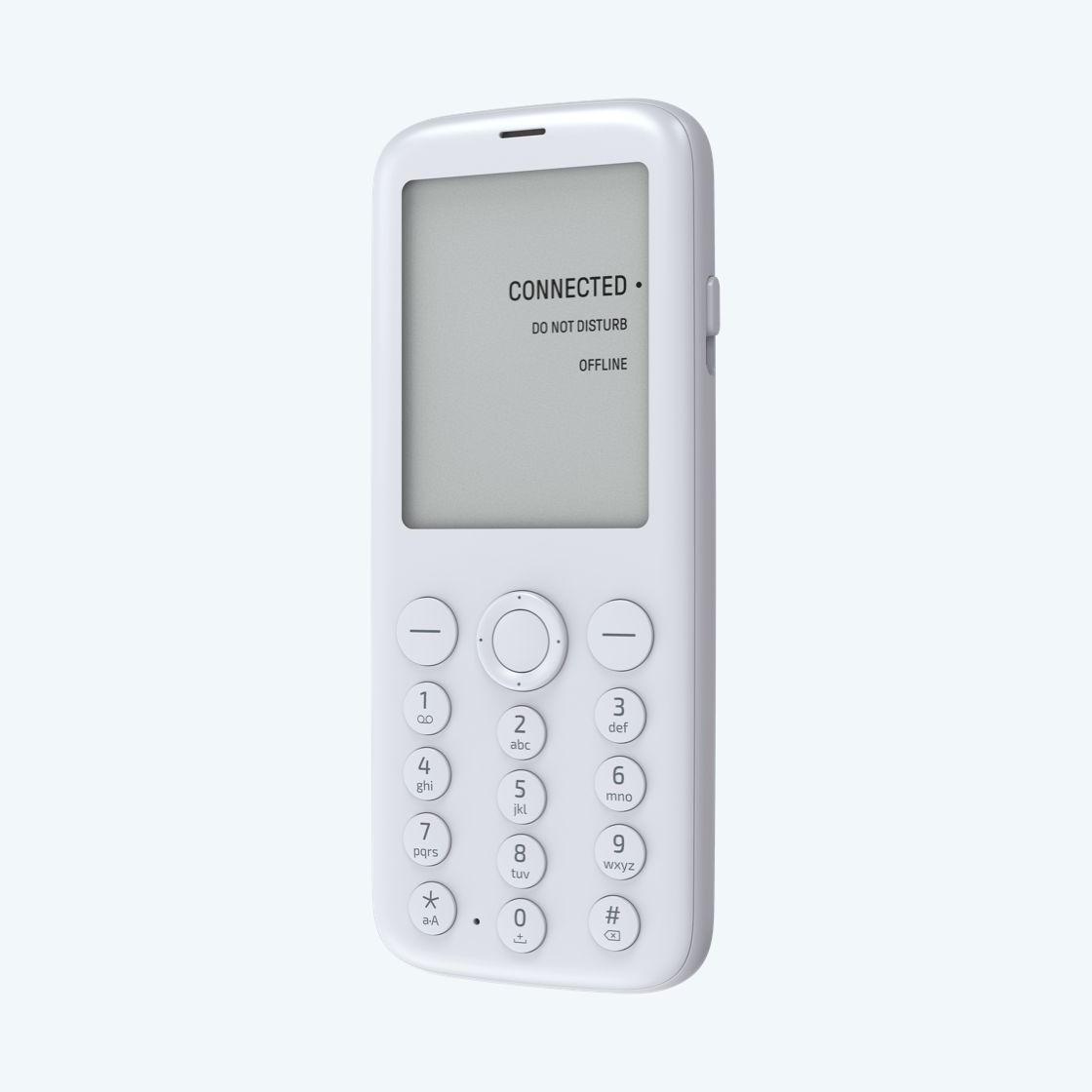

In Mudita products, the frontlight panel illuminates the display, so that the light is uniform. It can be used both day and night, without glare. We've selected diods that are warmer than in standard LED used for screen illumination. [2]
A prototype of Mudita Pure.
