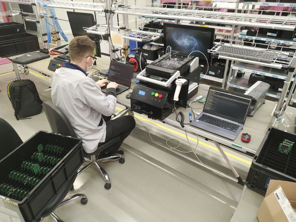

Testing a new batch of Main Boards. We tested 200 Main Boards
97% of MBs received a PASS rating in tests
