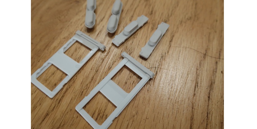

Mudita Pure sliders and SIM trays

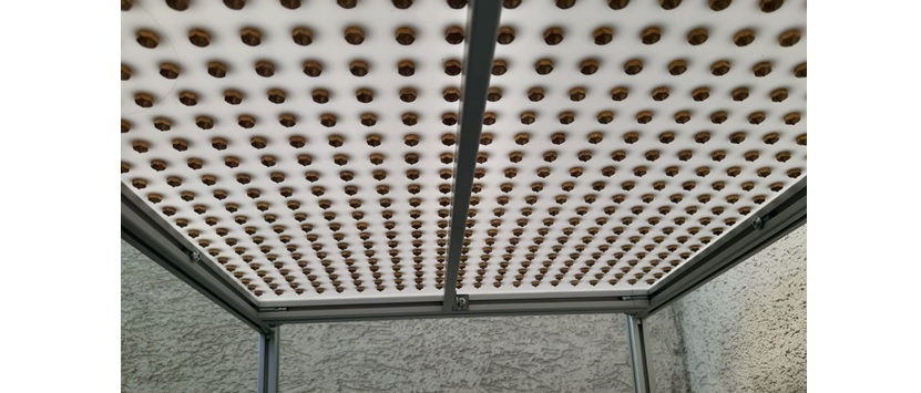

IP rating
We are in the process of preparing to establish and test the IP rating of Mudita Pure. Since the final body casing is not finished yet, we are unable to conclusively establish the final IP rating. However, internally, we have developed a sophisticated testing tool in the office, which we are using to examine and analyze possible IP ratings. We are really proud of this development, because it will allow us to internally determine possible IP ratings before final testing is finalized.
To meet ISO 60529 requirements, we have built a custom dripbox with controlled water flow through  a SEN0216 flow meter connected to an Arduino Nano. The Arduino Nano is a small, complete, and breadboard-friendly board based on the ATmega328 (Arduino Nano 3. x).  The Arduino Nano comes with a crystal oscillator of frequency 16 MHz. It is used to produce a clock of precise frequency using constant voltage. We are able to control the level and frequency of water used in the testing.
The dripbox with controlled water flow
